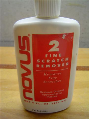

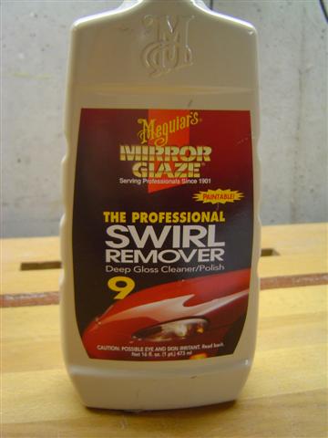

I use Novus 2 fine scratch remover or Macquire's 9 swirl remover.
PostPosted: Sun Mar 26, 2006 2:13 am
Posts: 908
#9, followed by #7
#7 is a non-abrasive...
PostPosted: Sun Mar 26, 2006 2:23 am
Posts: 993
I use the Meguires #9 swirl remover. I think that you may find the polishing compound pastes actually leave the finish a little dull. I've tried several kinds before and they seem to be about the same as 1800-2000 wet sandpaper. I wasn't able to get a great shine until I went to swirl remover, then polish.

I like the Novus #2 as well, although I'm not a FP guru. Takes the scratches out of cds and dvds too.

#9, followed by #7 works great for me.

Well, yesterday I went to Pep Boys and got meguiar's 7 & 9. I buffed out a
tele I sprayed with the cheap deft spray can lacquer from the hardware
store. I believe I'd sanded to 1500 but don't remember. It buffed out so
incredibly easy by hand and I've never actually had a finish this glossy. I
used 9 first, followed by 7, as Mario and Arvey described (thanks guys!).
